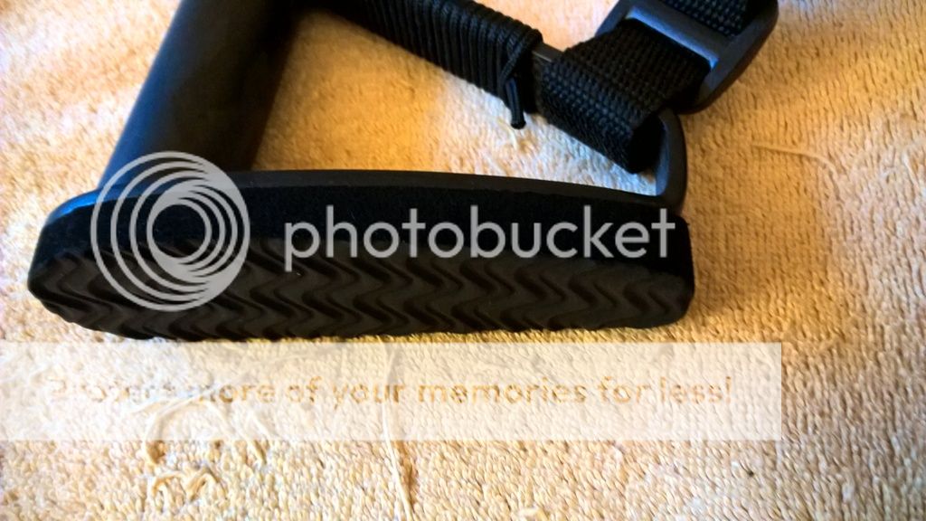

Somewhere here there is a thread where a member used a flip flop and made his own recoil pad.
#10 ·
That was me. I bought a pair of cheapo size 11 beach flops at RiteAid for about $5. You want the kind that have just one layer of dense foam rubber. There was enough material to make 4 recoil pads. Use your buttstock to trace out the rough size and cut the sandal with a sharp knife or tin snips. Then carefully trim to exact size with a belt sander or sanding block. Apply a generous layer of PVC cement to both the pad and the stock, then clamp in place and let dry for 24 hours. Works like a charm and definitely tames the modest bite of a 6.8 round.
BTW, what got me started on this was the sharp-toothed rear surface of a Rogers SuperStoc. Even though the 6.8 round is relatively low recoil, pair it with a sub-5 lb AR on a hot day and you can definitely feel a sharp plastic edge digging into your thin skin. - CW
