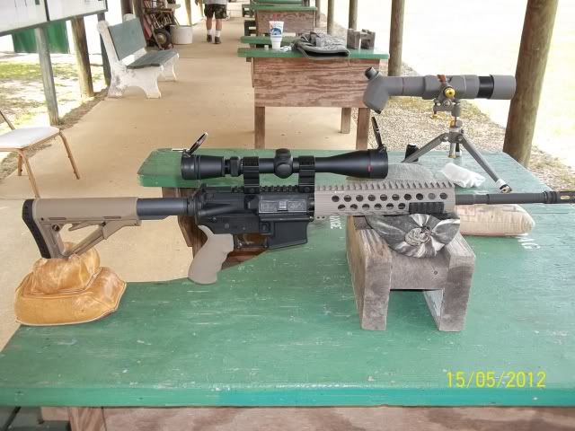

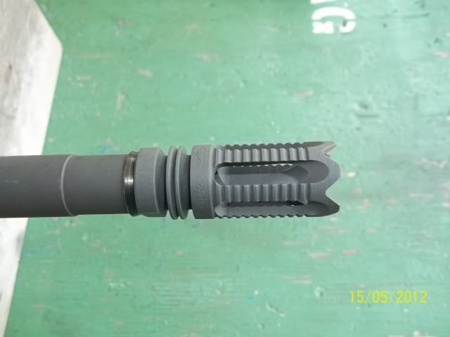

Well i just completed my 6.8 with a grip and new muzzle brake/flash hider before that I was center pinching a 1"dot at 50 yds. Rifle was sighted in with an A2 brake, nothing else changed but to switch out the brake for a YHM 80-5C2(yes made for a 6.8), knew I had to confirm the POI. Well first 2 shots grouped almost touching 2 1/2" Low in the 6:30 position. I adjusted the scope and got it right back on center of 4 shots .493"..the circle was the last 4 shots)OK I am happy.
The question is some told me the brake change would have NO impact some said a little but all said to confirm & shoot the gun! I did and the above was the conclusion. I must say I was very surprised at 2 1/2 low at 6:30, I really have never had that happen when all else was the same. Your conclusions and comments please.

If I'm reading the OP right, the orig was an A2 flash hider? If so, the A2 doesn't do anything to reduce recoil/muzzle rise. It just helps eliminate flash.
#8 · (Edited)
Good point on the torque, The A2 was down tight, the YHM had to be indexed and so is not as torqued, could not get it around another revolution. Don't get me wrong it is tight but not like the A2 was. Yes same crush washer.
Another good point, The new one is a combo where the A2 is just a flash hider!

Yes all of the above are true (harmonics/crown/weight) but the A2 flash hider is only ported on top and sides to reduce a dust signature while shooting prone. Gasses disperse differently when using different muzzle devices ie; flash hiders/muzzle breaks/suppressors. POI with these changes are normal and expected. Choose one, sight it in, and call it a day. Many more factors can be added as well but you get the drift. Just my .02 for what its worth! Been aroun BR's for a little bit.
