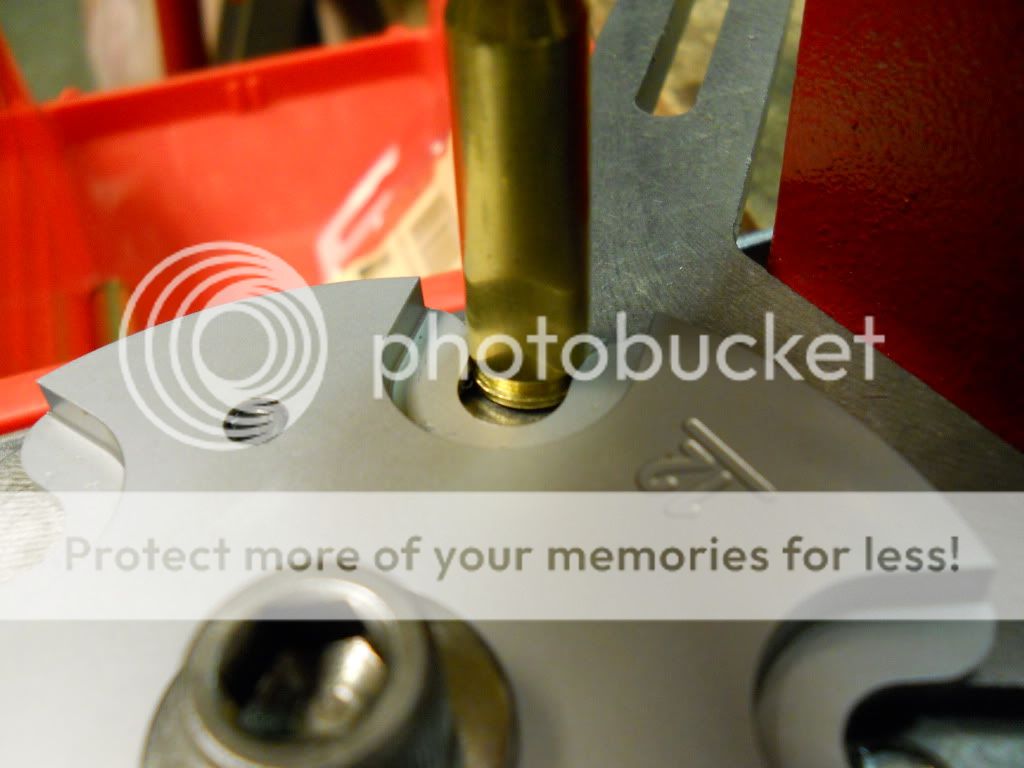

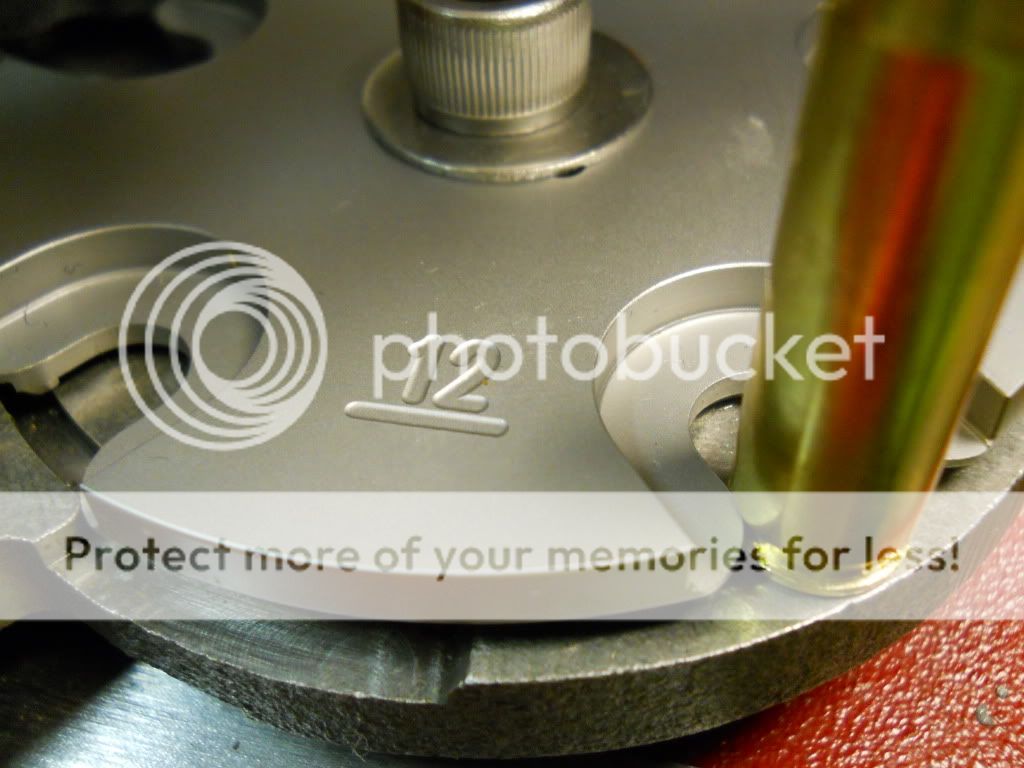

Hi folks, just rec'd another case activated lower assembly to use for 223 and 6.8.
6.8 cases wont fit the #12 shellplate like they're supposed to. I've reloaded 9mm w/o a hitch, getting started to do 223, #16 shellplate works ok. Pics shown w/o retainer spring in place. Prbably send these pic to Hornady as well, figured I'd see what you guys thought first.
Any ideas??? Thanks!

The problem I see is there is no bevel on the lip of the plate to match up with the case head. Mine also does not have the line under the number 12 stamp. Please let us know what Hornady says that plate is for.
I would agree its missing the bevel to accept the brass.

Does that shellplate have the 1/4" groove on the underside for the EZ-ject cam? Can't tell from the picture. Swatret is correct also that there is no bevel for the extractor groove in the shell recess on your plate. My #12 does NOT have the underscore on the topside number, and feeds cases perfectly. The current catalog lists the #12 as part #392612, and there is only one 12 in the list. I think you may have one of the old shellplates for the pre-EZject LnL AP.
Let us know what Hornady says.

LNLAP/Pro-Jector prior units.
I have the Older Style and The 12 and 16 sets. I have do not have an underlined number
The box has a 392612 part Number and the boxes are white.
If you do not have any of these I have no idea what you have but the
LNLAP and ro-Jector Shell plates I Have do not have and underlined number.

I called Hornady this morning before leaving for work. The guy say's that they need to see the shellplate to determine what is wrong, if anything. He says that maybe the brass is out of spec...what brand am I loading. SSA I tell him and he states that it might be out of spec... Yeah Right, I'm thinking, knowing the guy is just toeing the company line, and rightly so. The guy says that if the plate is faulty, they'll make it right.
After looking at my other plates, I think the missing beveled edge is the culprit.
The line under the #12 is an id mark of the actual maker is what he told me.
Sent out the faulty plate after work, we'll see what happens.

Finally got the shellplate in from Hornady yesterday....I love their products, and the cs is helpful and friendly. I just can't believe it'd take 2 mos for me to get it....sans the cover I might add.
