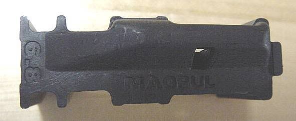

1. Black Magpul 6.8 marked followers on both 25 and 5 round Marlube mags:

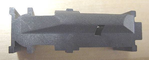

2. Grey CP unmarked followers on 25 round Marlube mags:

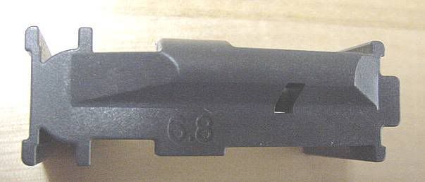

3. Grey CP 6.8 marked followers on 25 round Teflon coated mags. Note the absence of the two side support ribs at the follower midpoint which are found on the unmarked gray follower above:
Here is a side view with the black Magpul on top, the 6.8 marked gray follower on lower left and the unmarked gray follower on the lower right. Note the shorter legs of the unmarked follower:
The black Magpul followers were receive on a quantity order back in May.

Larry at CP Products just informed me that the latest 6.8 Follower is the Gray one WITH the 6.8 marking...
