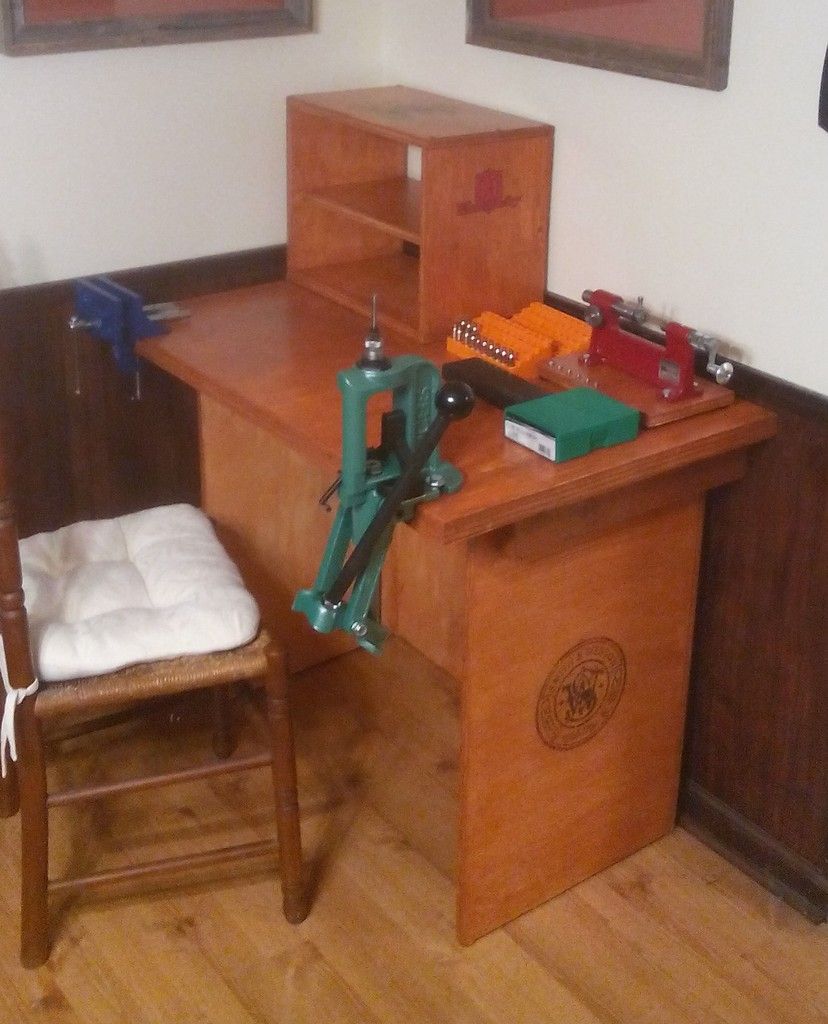

Needed a bench for my newly purchased press and equipment. I needed something small enough to put in my room or in another small space area as needed.
I needed it to be as cheap as possible also.
I purchased one sheet of 1/2" sanded plywood and had Home Depot slice it up into 2' x 4' strips.
I already had some 2x4's. I purchased some screws and felt pads for feet so it doesn't scratch the floor if slid around.

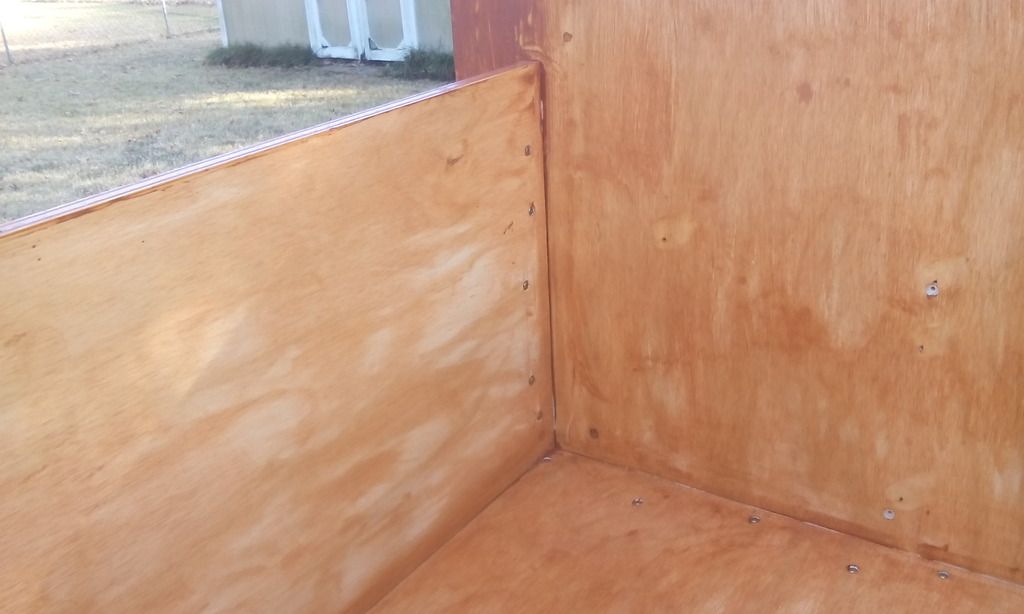

I cut two side panels to 17" wide by 31" tall. The back panel is 31" wide by 31" tall. The top is two sheets are 24" deep by 38" wide. Sheets are stacked, screwed and glued to make the top thick enough. The shelf piece is made from some of the scrap pieces. It will be attached after the finish is completed.
The small flat piece is a base for my Hornady case trimmer.

My initial plan was to leave the top removable and the three sides hinged together so they would bi-fold together into a single sized panel group for storage. However, I decided just to screw the side panel uprights into the table top support 2x4's from the inside. Its now like a pedestal or podium.

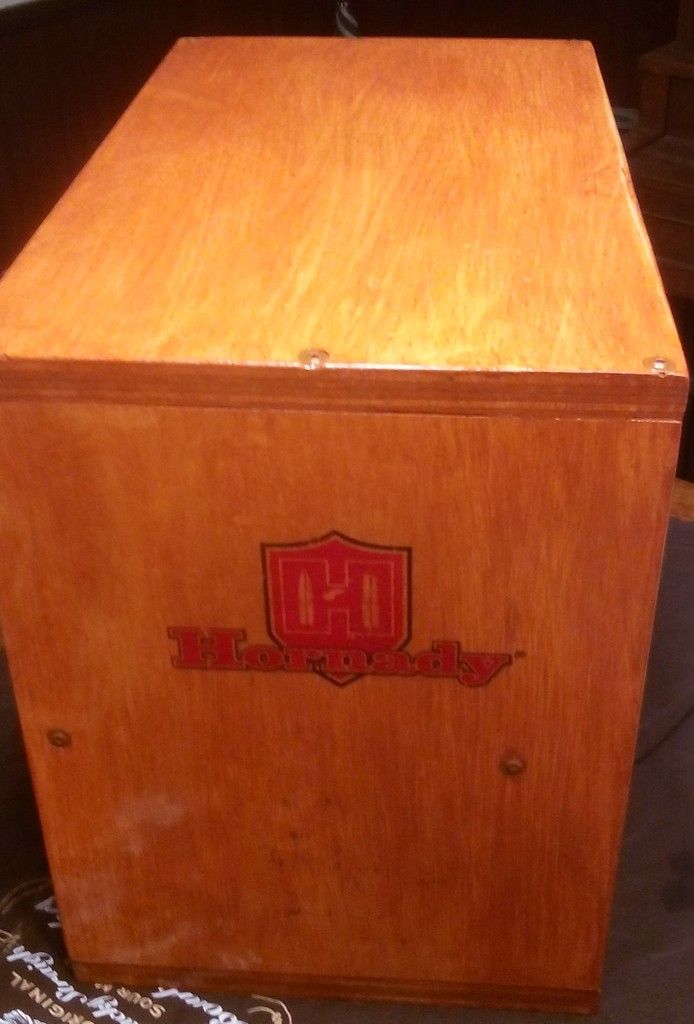

Got it stained and poly coated. Also did some decopage stuff to it before I sealed it.

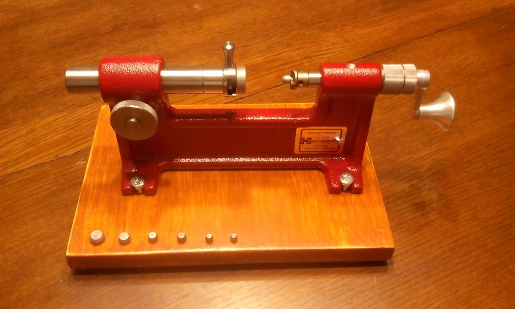

Got the Hornady LnL Case Trimmer mounted on its base. Keeping it mobile so I can move it out of the way.
What is this thing??? Must be as old as the guy CrayJ was looking for! LOL This is kinda like owning an old crank start Ford!:a39::a21:

Finally finished. This is not where it will be. Its going into my room. This location just for photos.
My last bit of decopage. Put a Winchester image on the top shelf.
