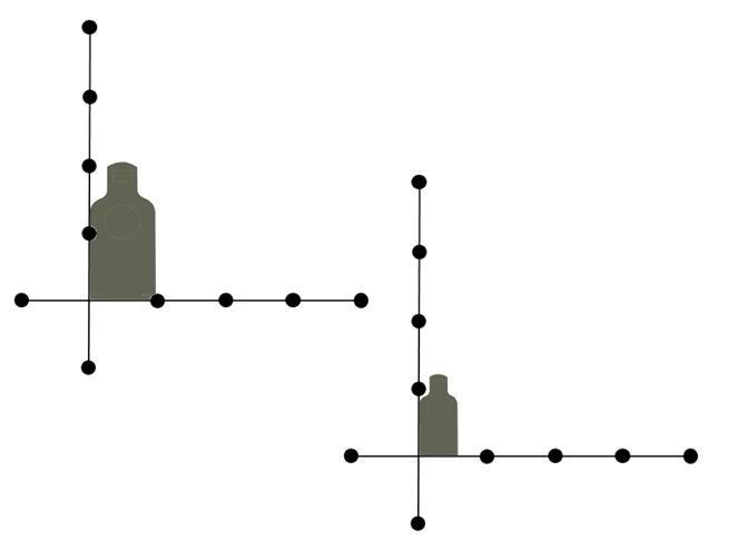

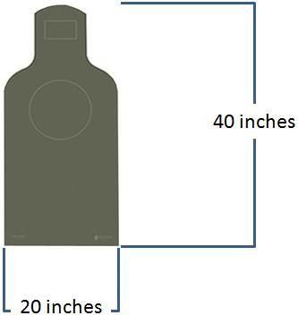

Let's work on this. I have a 20"x40" target.
Now since I know how big a target is, all I need to do is line the target up in my reticle to get the Milrad reading.
The target to the right reads 1.2 Mil tall and .6 Mil wide. So lets use these numbers to get the range
Height:
40 inches x 27.778 = 1111.12
1111.12 / 1.2 Mil = 925.933 or 926yds ;)
Width:
20 inches x 27.778 = 555.56
555.56 / .6 Mil = 925.933 or 926yds ;)
WOW HOW DID THAT HAPPEN??????????????????????????????????? ;)
So tell me the range to the target on the left.
You should get a range of 555.56yds on both height and width.

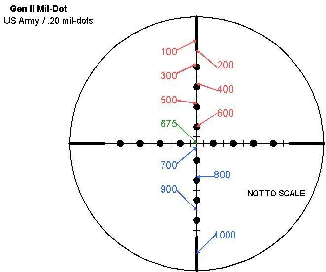

Now that we have covered the basic information and usage of the Mil-Dot reticle lets look at more advanced applications. We now know that a Mil-Dot reticle is a unit of angular measurement as is minute of angle. You can now use the ammunition ballistics that you have in MOA for hold-over's, hold-under's and windage to hit a target.
This is simple to do. Let's use the Federal Gold Metal Match .308 win Ammunition (FGMM) with the 175 grain bullet as an example.
Since we now have the ballistics that our rifle shoots. You need to pick a ZERO range for your scope. Then get the adjustment-ups or adjustment-downs from that MOA drop at that range to all the ranges you plan on using the Mil-Dots for hold-over's and hold-under's for.
The easiest way I have found to get the best ZERO setting on the scope is to look at your MOA from the closest range you will shoot at to the farthest. Most of us will use a 100 yard to 1000 yard ballistic sheet. For the Federal Gold Metal Match .308 win Ammunition our chart lists 37.37 MOA as the total drop. We take the 37.35 and divide it by3.43775. This gives us 10.86 Mils of total drop. Most reticules have 8 Mil-Dots with a 10 Milliradian over all size reticule. I have found that a ZERO SETTING between 600 yards and 700 yards works best for the FGMM .308win ammunition to cover 100yards to 1000 yards.
With that in mind, we will use the 675 yard data as the ZERO but you can use any MOA ZERO you would like. Some use a 400yd ZERO also to engage targets from 100 yards to 800 yards. The 675 yard data is at 18.75 MOA setting on the optic's turrets from the 100yd ZERO. Now I need to find out what my adjustment-ups and adjustment -downs are from each range to 675 yards. If you subtract 675 yard MOA from 700 to 1000 yards you get your adjustment-ups. Then subtract the MOA at 100 to 500yds from the 675yd MOA for adjustment-downs.
You're adjustment-up / down chart will look like this:
Ok the fun part. We have the entire math we could ever want now. To make a hold-over / under we must take the adjustment-up/ down and divide it by 3.438 to get is value in Mil so we can use it with our reticule. Using the same data charts this is how it's done.
I have my adjustment-downs and ups. All I have to do is take the adjustment-up or down number and divide it by 3.438 to get my mil-hold.
EXAMPLE:
400yard adjustment down from 675 yards = 11.21 MOA
11.21 / 3.438 = 3.26 Mil-Hold under 675yd ZERO
800yard adjustment up = 6.48 MOA
6.48 / 3.438 = 1.88 Mil-Hold over 675yd ZERO

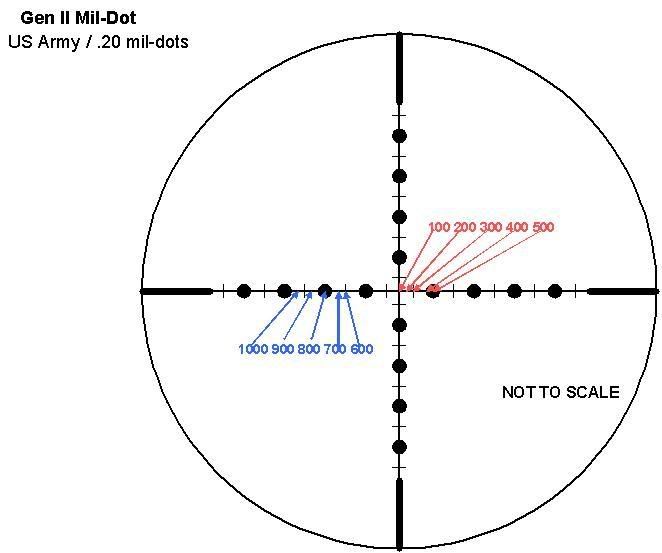

To do the windage holds. All we have to do is take the true minute of angle wind drift and divide it by 3.438 and you get the wind hold in Mil.
This is how your holds will look like when you need to use them.
Elevation Holds
Windage Holds
You should get a range of 544.54yds on both height and width.
Nope...
If the example to the left is 2mil tall as it appears to be...
then 40" x 27.778= 1111.12 /2mil = 555.56 yards....not 544.54 yds
However if the target is 40" tall and 20" wide then the width should be 1mil...but it appears to be less than a a full mil. Perhaps .98 mil which would then calculate to approximately 544 yds. Yet the height would then have to be less than 2 mils but it does not appear to be less.
It appears the actual distance calculated would be subjective... depending on how closely a shooter estimates his target size in mils. I.E. Is it 1 mil...or .98 mil?
I realize a 10 yd variation at 55O yds is not going to be a make or break situation...but range estimation does appear to rely greatly on the tolerance used in determining target size.
Did I miss something here?
How did you determine a 544.54 yd range? That works out to a target width of .980164 mil.
Kerry

owenslee said:
Nope...
Kerry
I fat fingered the numbers, there. Sorry about that. I will fix it now.
