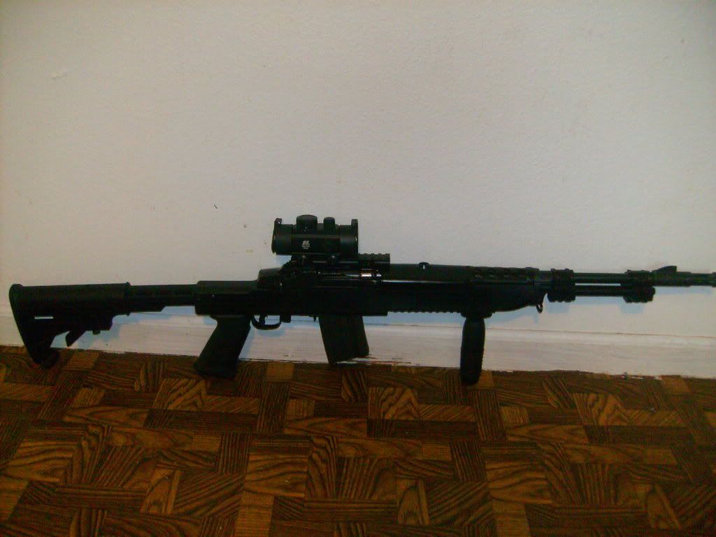

Hello The mini 14 6.8 is 1-10 twist. I know what u mean by the mini 14 223 barrel heating up.I have one that was made in 84 and after 10 shoots in a role the thing is so hot u dont want to toughch it.I have found adding that bar under the mini 14 223 barrel helps on the grouping.
here is my mini 223
and heres what my mini 14 6.8 looks like
I did it lol i found out how to post pic lol
