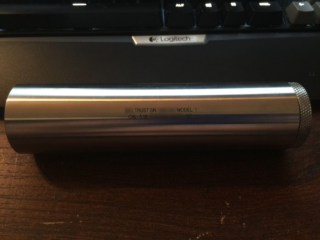

Alright. So it's nothing fancy, and does what it suppose to do, though it is a bit louder than I want it but over all I am happy with it. a big thanks to the folks over at http://form1suppressor.boards.net/
Engraving was done by unknownpro. Quick turn around and easy to work with. Its a 6" Apogee stainless tube.

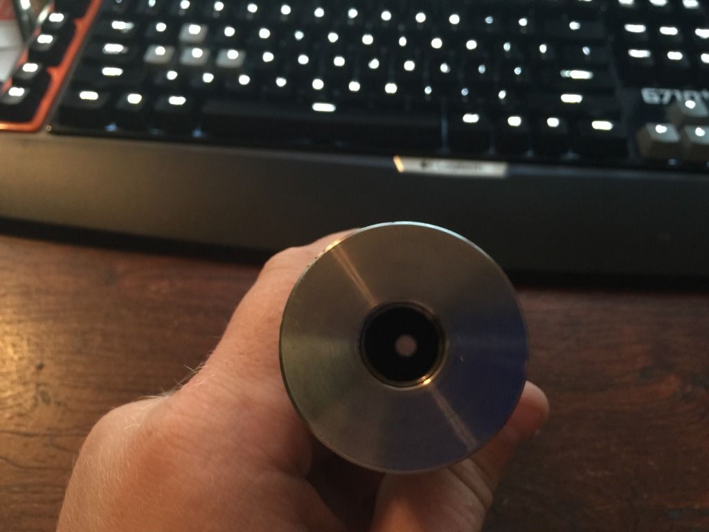

End cap from rmletu at https://superprecisionconcepts.com/. Opened upped to .291
1/2-28 Threaded cap from SDTA. Its Ti.

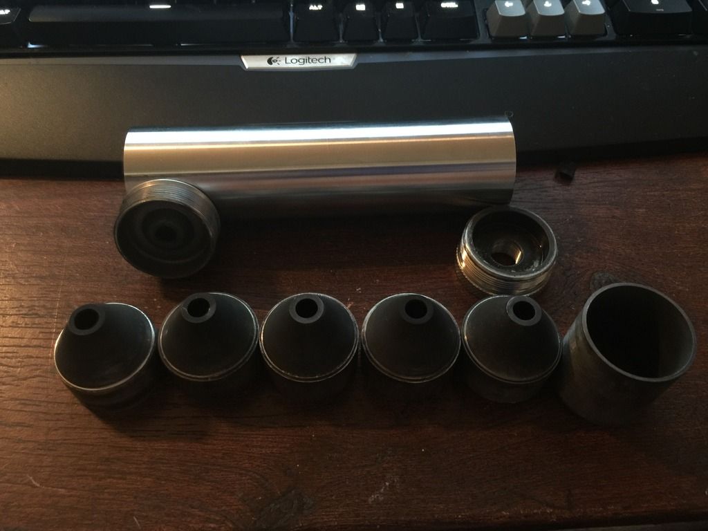

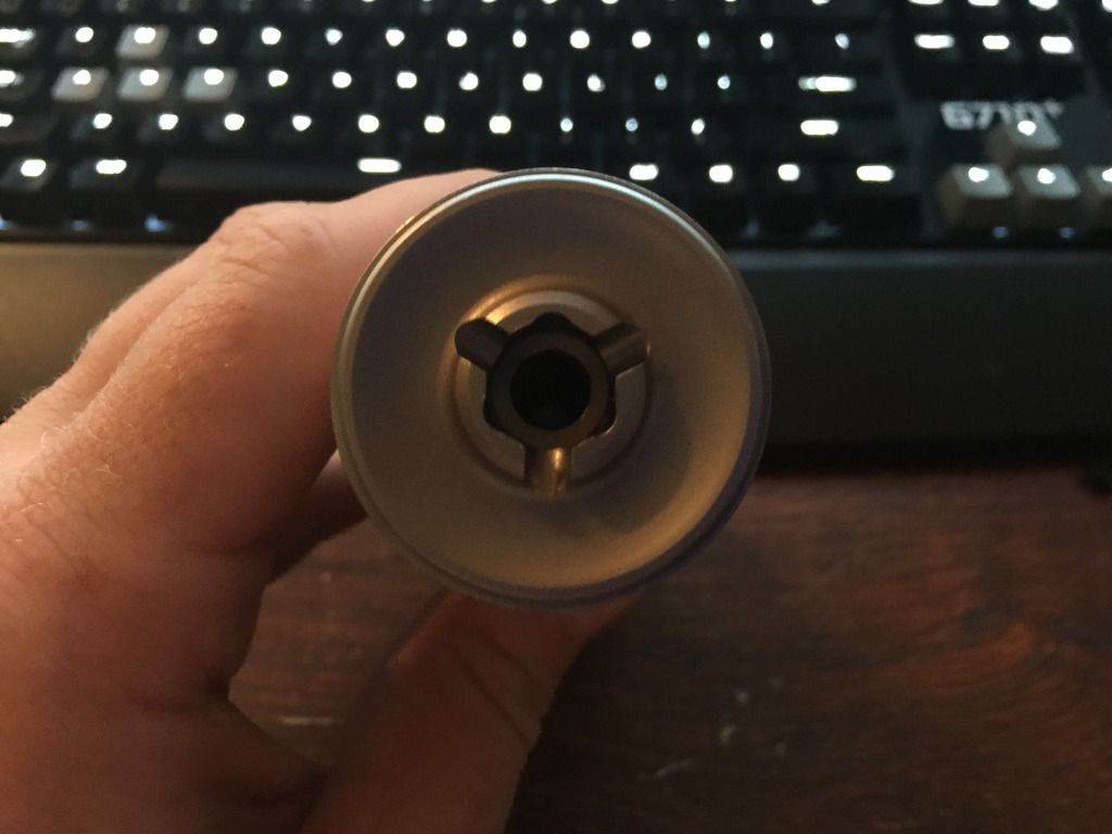

5, 60 degree stainless baffle from poolshark at https://zmachineworx.com/. 4 of the 5 are opened upped at .271, the 5th one is at .291

how do you like that "hex" end cap? looks nice, a little spendy over the standard knurled SDTA caps but nice flush look

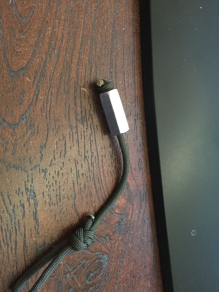

I like it a lot. Only gripe is has a beveled end to sit flush which when I had the tube cut down it was a little extra work to get it to properly seat. When I bought it, it came with the tool to fit in the end cap. Believe it or not, that end cap was a "blemished" end cap lol.

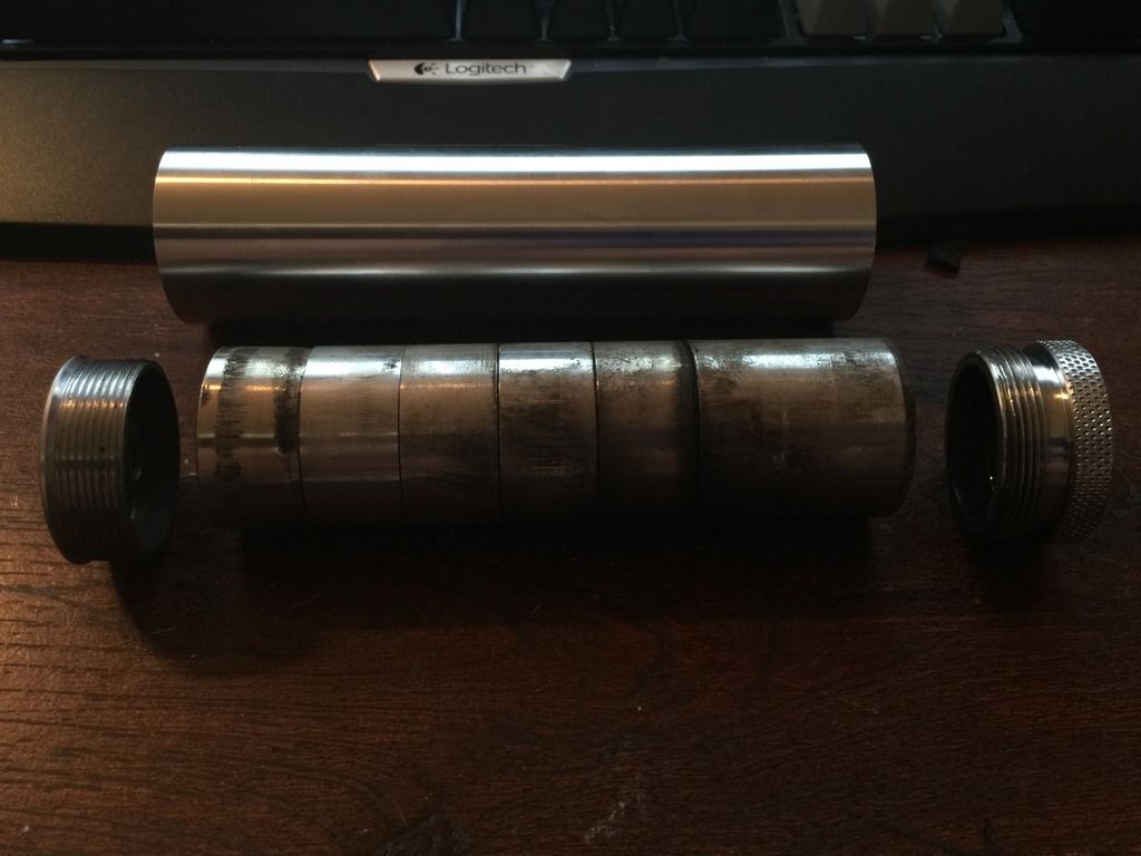

now look inside your suppressor --- 22lr puts a ton of black muck inside a suppressor (unlike centerfire) --I know i've done it too ---its fun to shoot 22lr through a CF suppressor but it's better to have a dedicated one---I will note that 22lr through a dedicated 1" diameter, 6" long alum suppressor is actually quieter than through a SDTA 10" ti .277 suppressor ----I can't hear your video as I have no speakers on my terminal, but if you want to hear stupid quite 22lr ammo try the CCI 22LR quiet ammo (40 grain bullet @710 fps) it is crazy quite (but wont cycle most semi autos)-- maybe that was what you were shooting when it wouldn't cycle your gun there
Yes it it didn't take me long to figure out I need a dedicated 22lr can. Maybe at tax time. But I always run a couple rounds of 223 through it.
