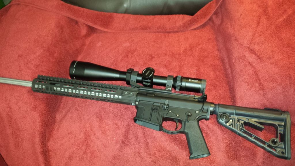

This one is built for Mike, only the highest quality parts have been used. It could be built lighter, but no aluminum BCG was harmed in this build.

Build list and prices
2A Balios ultra lite receiver set
Wilson Combat Barrel $342 (inc. shipping)2A Balios Handguard $233.61 (inc. shipping)
JP LMOS lite carrier $179
Rubber City Adj Carier $40
Port door rod $8V7
Port door $37
POF Buffer Tube $44 (inc. shipping)
Tapcon Buff/Spring $36.20
Bullet Button $10.49
Mag K Grip $20
V7 Combo Pack $45
V7 Selector $49
2A Ti Pin Sets $36
V7 bolt Catch $17
V7 mag catch $27.16
Mike will be using a variable power scope that is out of my price range. I am using my 24 power Vortex Viper to sight this beauty in. will be shooting 26 grain and 32 grain ammo to get the adjustable carrier dialed in.

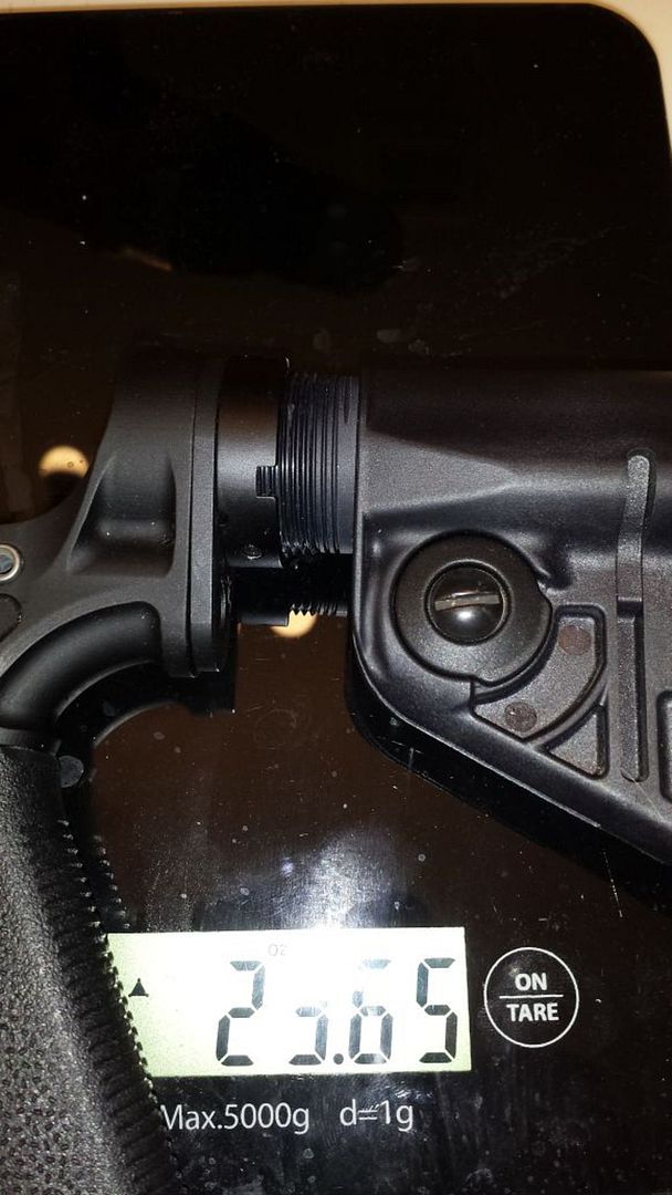

is that a set screw castle nut on the buffer extension?

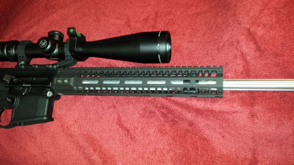

Took 3 rounds of 20 minutes to get it sighted in. I don't know about lapriester , the recoil is barely over a 22 LR with the adjustable gas and light weight JP LMOS carrier. I only use splatter targets, although I had a brand new target with zero holes.
Started at 25 yards, then 50 and then 100 yards. Going from 25 to 50 was also brutal, was 6 inches high, not too bad at 100.
With my scope set at 24 power I could see where every bullet hit immediately.
I might just get a barrel and try out the cheapest ammo, the S&B.
Actually I might get this barrel and get it re-profiled to a lighter weight (34.6 oz. stock). With the tiny hole it is basically a bull barrel. I might even go down to a 0.625 gas block.

Today was much better, first two shots with his 39 grain plastic tips were in the bull-eye. Separate targets, only the second time I have shot since early May. Already 100 degrees at 8 am. Don't get better later either, 105 at 8 PM.
Started adjusting the adjustable carrier key, as I was way over gassed with the 39 grain. Ejection at 1 to 1:30. Adjusted down and checked the function with this round using a 223 PMag and a Lancers. Perfect function with both mags.
Next round of shooting with the 26 grain Corbon 4200 FPS Varmint Grenade were two more bulls-eye shots. But ejection at 1 again.
I am always amazed how when the gas block (or carrier key) is adjusted close to 3 ejection the group size usually shrinks a lot. I was at about 1-1.5 inch group and that was reduced to the size of the bulls-eye, just smaller than a nickel. The 26 grain did NOT LIKE the PMag, first shot would not chamber. The Lancer and metal lips functioned perfectly. Of course the Surefire 60 round magazine would be a cool factor
This rifle will shoot better than I can at this time. I need a lot more range time to get back to decent shooting. One sweet AR!!!!
