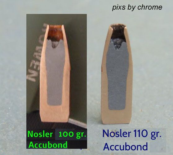

I've used the Nosler 110gr Accubond, but only the last 2/3 of the bullet is bonded. The first 1/3 is not bonded so the front of the core can fragment early and the clean jacket can fold back close to the shank for deep penetration. In other words, it is supposed to mimic the Partition. The deer I killed with one at 200 yards dropped in its tracks, The bullet went through both shoulders and kept on going. The exit hole was not noticeably larger than the entrance. So if the deer would have run, I don't think I'd have had much of a blood trail to follow.
In general, with fully bonded bullets the lead core stays stuck to the jacket petals, keeping them in a more open, wider mushroom. So they don't penetrate as far, but leave a wider wound channel. I'm just wondering if, on medium game like deer, you would still get complete penetration with fully bonded bullets and also get a wider wound channel and larger exit hole.

I've used the Nosler 110gr Accubond, but only the last 2/3 of the bullet is bonded. The first 1/3 is not bonded so the front of the core can fragment early and the clean jacket can fold back close to the shank for deep penetration. ....
Brazos_Jack, I have several AccuBonds recovered from terminal testing and game. The lead core is fully bonded to the copper jacket. As you can see in the cross section below, because the ABs are tipped, they have a hollow expansion cavity with no lead to bond to the very front of the copper jacket. The 115 MSR and Ultra are soft-points with the lead all the way to the tip of the bullet.
