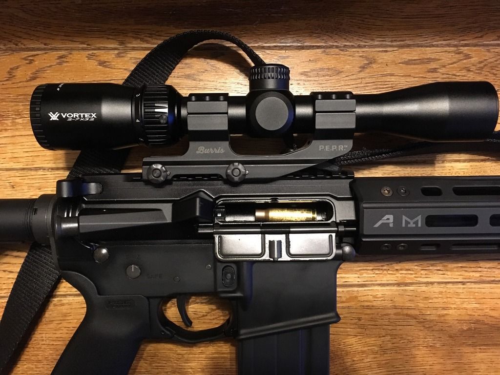

Bought some 115 MSR to try out as I am looking at other options than my standby load, 120 SST. I loaded 5 rds in my 15rd mag and attempted to shoot. Each rd failed to properly eject. Fired case gets jammed sideways is ejection port while bolt is trying to feed new rd into the chamber. The only ammo this set up has seen is factory 120 SST and I have had no issues. I Loaded 5 rds of 120 SST into same mag and fired away with no issues. I have seen a few posts about known issues with this ammo but do not recall anyone figuring it out. Is the powder being used the problem for some?

1 rd of 115gr Fusion loaded and fired. Here are the results...
1 rd of SST loaded and fired from the same 15 rd mag, no problems.
did the bolt lock back with the bolt stop? or did you do finish pulling the bolt to the rear to lock it? if it locked open on the stop when you fired it, i'd say you have a ejector or extractor issue.

try putting an empty case in the chamber drop the bolt on it, then pull the bolt to the rear slowly and see what happens, see if the case flings clear of the port or flips around like in the pic.
