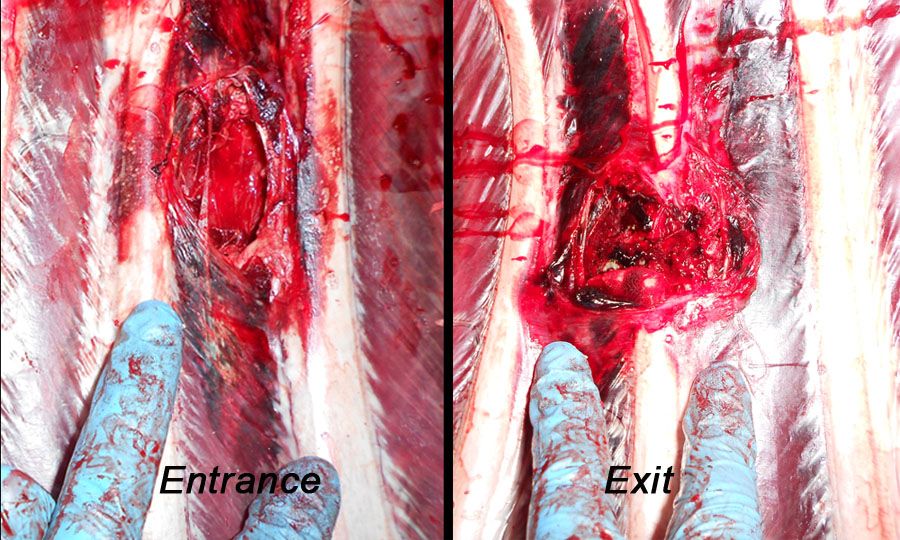

nonnieselman has recoverd a 105 MKZ from a hog so I've included his pictures to show how the bullet expands.
Thru a shoulder and 7 ribs. 18-19" penetration
MKZ Wound Channel

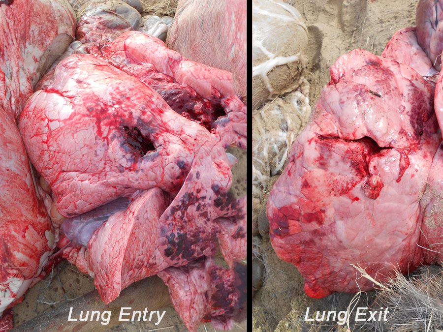

After fielding dressing, you could see the bullet was fully expanded before entering the chest cavity by the 2.5-inch entry wound between two ribs. The exit wound was the same size and broke a rib going out. The lungs clearly showed the wound channel with the off-side wound looking like a 3-pointed star - maybe a result of the 3 pedals of the expanded MKZ. There were no indications that the bullet lost any of its pedals thus retained 100% of its weight during the terminal phase.

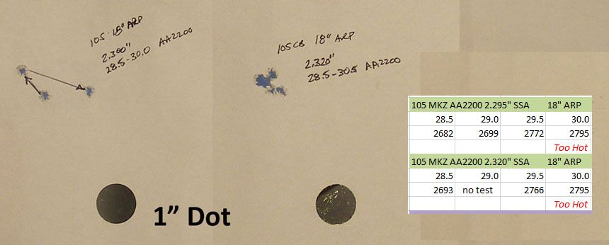

rvrrat14, here is my load data for mag-length COALs with the 105 MKZ. I shoot single powder charge vs velocity ladders when I first get a new bullet to find the performance boundaries and look for indications of the accuracy node. In this load ladder, I used 0.5 grain increments. Note I load longer than mag length frequently to look for better accuracy. I found the node for my rifle 18" ARP. I have continued to maintain 0.5 MOA groupings with the 105 MKZ in my 18" ARP. The freebore in my 20" ARP that I used on this hunt is 0.035 longer.
Note, Hornady and Federal brass has less capacity so you will need to reduce your starting load at least another 0.5 grains to compensate.
I'm debating 105 again or go for the 120s
I don't think you can go wrong with either. I would have taking the 120 MKZ with me on this hunting trip but I didn't have time to develop a load for it. The 105 did an excellent job and I like its flatter trajectory because I hunt with a Trijicon AccuPoint that has a green triangle. When I sight the AccuPoint in at 200 yards with the 105, 250 yards is the center of the triangle and 300 is the bottom.
Gotcha! So which loads were which shots on target? Is the 29.5 the far right on the 2.295? Like that velocity from a 18" ARP, too. Same as I shoot for main hunting weapon.
