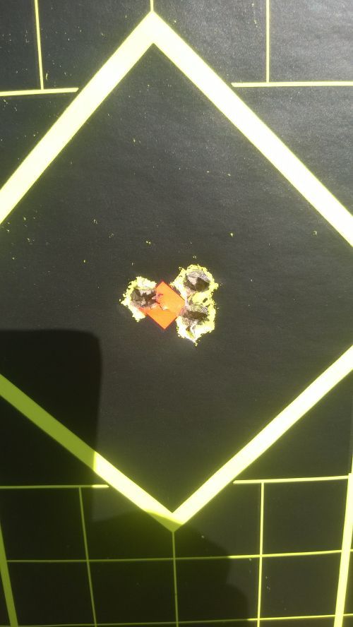

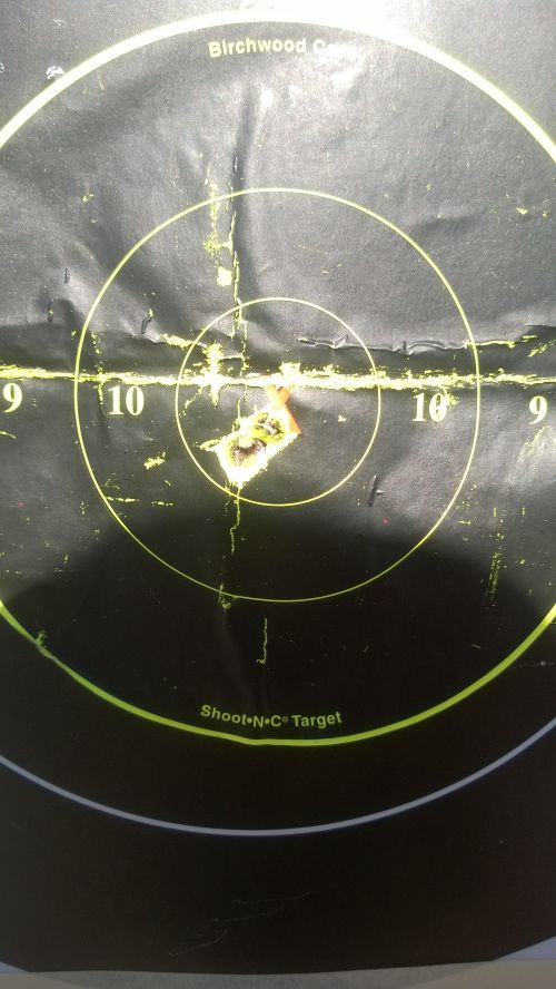

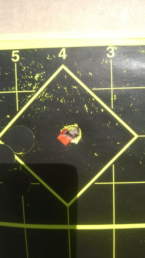

NEVER build an AR308 without an adjustable gas block
I should mention I would NEVER build an AR308 without an adjustable gas block.
A standard weight AR 308 BCG and buffer/spring acts like a sledge hammer! The AR 15 in comparison is a ball peen hammer.
But by using a light weight BCG and buffer (with adjustable gas block) it acts much closer to an AR15. HUGE difference.
The accuracy with the 130 Mk319 ammo really improved with the lighter titanium carrier. Before the 3-5 shot groups were one inch or larger. With the lightest BCG the accuracy was closer to half an inch.
