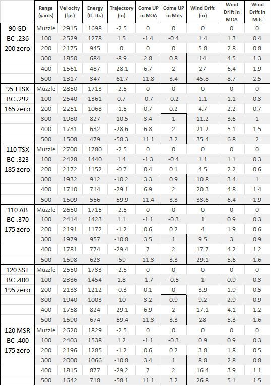

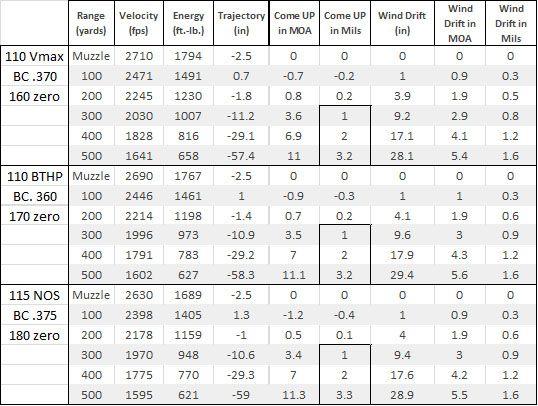

Thanks, CK, some good ballistic work. If you have a scope with a mil-dot reticle, it can be used for accurate hold over at longer ranges. I use this on my .270 out to 600 yards with a 100 yards zero. The first mil-dot is 300 yards, 2nd 400 yards, 3rd 500, and 4th is 600 yards. The 6.8mm doesn't have the performance to match the mil-dots in the manner the .270 does. However, the 6.8 works nicely out to 400 yards with a mil-dot reticle using a scope's magnification that provides true milli-radians, typically 10x. To accomplish using a mil-dot reticle with a 6.8mm, sight your 6.8mm initially at 50 yards then adjust elevation at 300 yards to be on using the first mil-dot and/or the 2[SUP]nd[/SUP] mil-dot at 400 yards (boxed outlined). The trajectory tables to accomplish this are shown below with associated 2[SUP]nd[/SUP] zero range. All the loads are pretty much on within a fraction of an inch at 50 yards.
Here are some hunting bullets. Note, that the 90 GD worked best using a 200-yard zero because of its lower ballistic coefficient [BC] which doesn't allow it to match the 300/400 mil-dots. This link goes into more detail on the process.

Thanks for the idea of putting the data into a chart. I edited the above post to put the data into a chart, although not as nice as yours...so here is an image of the comparison. I don't know how to make it full size though, so you need to click on it to view it.

Muzzle velocity, ballistic coefficient, slope up or down, and scope distance above bore all have a significant effect.
I don't have ready access to a 150yd or 200yd range. Using a calculator gives a good idea what poi at 100yd poa will yield for poi at longer ranges. Example: 95gr TTSX @2840 fps; 3/4" high at 100yd drops to zero at 165 yds and is 1-5/8" low at 200 yds. Energy drops to 1000 ft/lbs at 190 yds.

With a 90gr gd going 3000fps out of my 18" ARP barrel there is not more than a 2.7" difference in poa to poi from 0-250yds with a 50yd zero. At 275 it's -4.4” and at 300 yds it's -7.1". I'm not knocking what works for you but with my main hunting setup and distances I hunt this is what works for me. Good data though, thanks for posting. Most of us here are open to new ideas.

Myself, I use 200M zeros (218 yards) but most here know that I don't shoot a typical 6.8 in typical scenarios. I also maintain logs for each rifle with different zeros for different loads, temperatures, altitudes, shooting positions (i.e. standing vs prone), along with the various associated drops for each variable or combination. If I decide to shoot my 6.8 in a standing match at 4500' ASL on a cold rainy day, but my previous zero is set for 600' ASL on a warm dry day in bright sun while shooting prone, I can dial in a cold bore shot 95% of the time. (Wind is the culprit the other 5%, lol)
