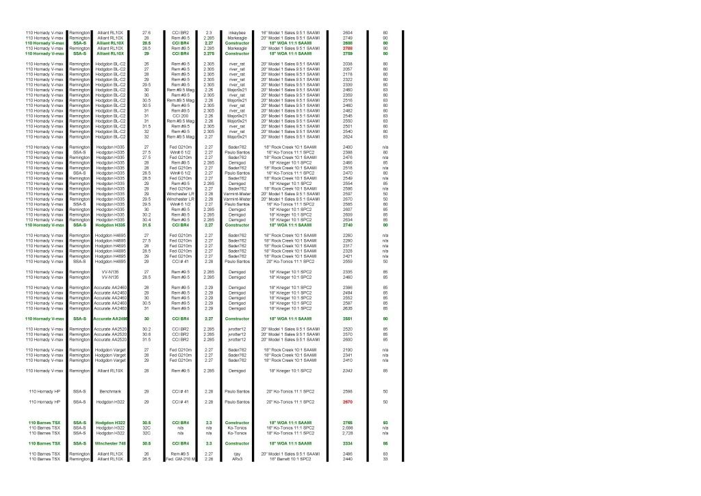

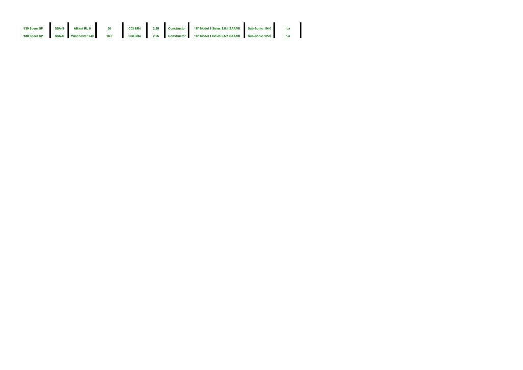

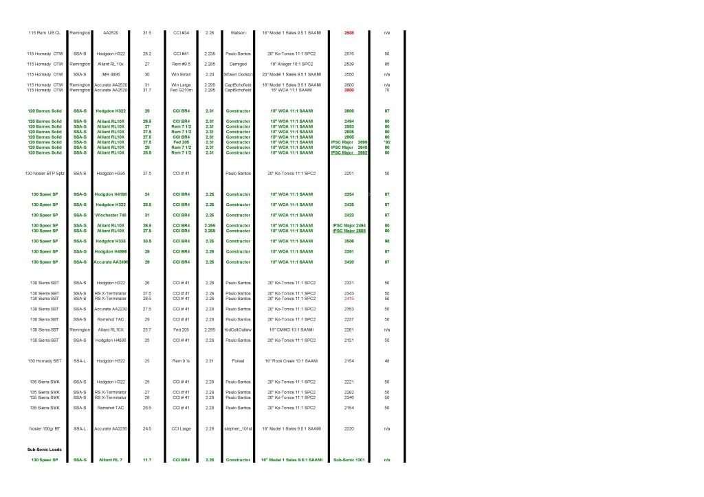

I did an extensive search on all the different sites for 6.8 loading data. I took what I found and compiled it into a spreadsheet then outputted the sheets into .jpg s uploaded them to a hosting site and then link them here. Sorry for the watermarks but I wasn't going to spend a 69 dollars for the program that converts the pages to images until I know its worth it. You can still readily see all the data under them as it is inversed b & w.
Hope this is helpful. This will be add to the "facts and info chart" on the main forum when I get it updated, revamped with everything in charts, and reorganized.
If you guys have more load data that isn't up there please post it. I will update it again when we have a good amount more. I need bullet / powder / primer / OAL of round barrel / description / velocity / temperature. Even if you have one of the loads posted but used a different barrel(maker, twist, chamber,length) or at a very different temp, we could still use it. Others that have the same config will know what to expect from their config.
I will Sticky this after its viewed and it looks OK.
If you go HERE you can download the actual excel file
HERE for .pdf
It is organized in the following order: bullet, powder by burn rate fast to slow, charge size, barrel length.
