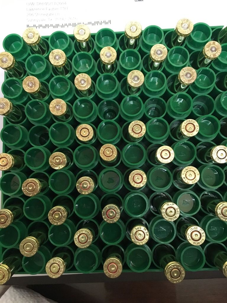

Just don't mix the two in your reloads because there could be some accuracy differences. Sort your brass large and small primer. Otherwise it's all good brass.
+1 on that plus each brass type will have their own max, e.g., what is safe in a Remington might be over max in a Federal. S&B and SSA have the most case capacity so never take a load developed in that brass and use it in another.
One other aspect. The neck thickness of the Remington brass I have is around 0.011" where the Federal and others is around 0.013". I use a bushing resizing die so I can't resize the Rem brass with the same bushing as the other 6.8mm brass. This is the only reason I don't reload Rem Brass. I don't have enough of it to warrant purchasing a bushing for it.
