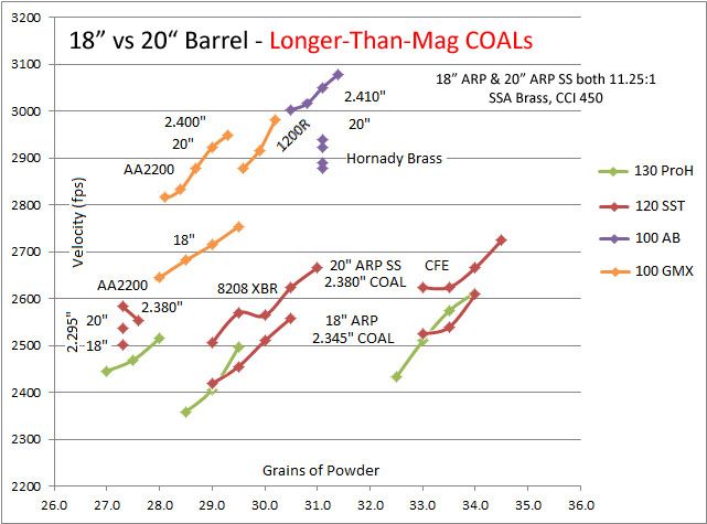

CFE and LVR might get you to your goal depending on the brass you use. Don't use new brass if you want higher velocity. Resized S&B will give you the most capacity (higher velocity with the lowest pressure). Results below are with new SSA brass so you can beat it with resized. Loading long will also help - all you need is the simple front of the magazine mod. Below are results with CFE and 120 SST. LVR will be ever so slightly faster for the same charge weight but isn't quite as dense as CFE. This was done with CCI450 primers. I since use CCI400 primers with CFE and LVR as it provided more consistency and less temperature sensitivity in my rifle.
http://68forums.com/forums/showthre...Magazine-COALs&p=613023&viewfull=1#post613023
Caution - these loads worked in my rifle but this is no guarantee that they will work safely in yours.
Note that some of the SST velocity progressions are not very linear. I just started using the latest SSA brass with the new head stamp (no arcs) during this range session. I found I had issues with concentricity with that last batch of SSA brass before Nosler bought them. This will cause fluctuations in velocity as seen above.

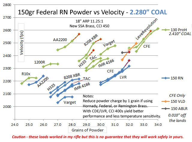

Granted, data below is with 130-150 grain bullets but you can see how close LVR and CFE are to each other.
http://68forums.com/forums/showthre...n-Competitions&p=662170&viewfull=1#post662170

I see one issue in my future with the CFE path. Would I even be able to fit 33-34 grains of CFE in a case if I were to load the SST's to 2.295 or 2.30. I know I can modify a mag and get some extra room, but I was wondering how well this project might work in a non modified set up.
Depends. I looked at my notes. 34.0 grains was max fill with new SSA brass at 2.345". An extra 0.035" of COAL got me in another 0.5 grains in my 20" ARP chamber. I used a 16" drop tube which makes a significant difference. Resized SSA or better yet, resized S&B, should get you 34-ish. I'm doing all my long COAL loads now with S&B brass to get me the extra case capacity, e.g., 1+ grain over Hornady or Federal.

The max will depend on your rifle and is around 2.38". Yamaraja recommends 2.36" fpr 100% functioning. However, check your rifle's distance to the lands with the SST. In my 18" ARP, the SST touches the lands at 2.35".
BTW, the Powder Charge vs Velocity Ladder I showed above was when I first started using 1200R (purple). You can see how much velocity variation it has after 5 range sessions - almost 200 fps. Over a year that grew to 300 fps with the 100 AB. Maybe I should just use it for fertilizer.
