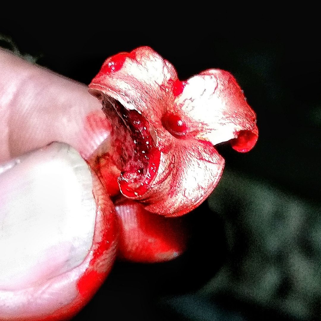

Recovered bullet that went long ways through a 180-200 pound boar from left rear to front right neck. Bullet was recovers sticking out of the skin rear cavity back protruding. 27.5 gr aa2200 2.295

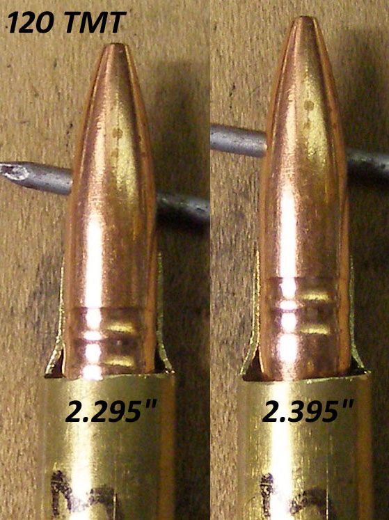

TLM, great pictures but the bullet performance you show is for the 120 MKZ, the hunting version. I believe this thread is for the 120 TMT (Tactical Match Target) which is design not to expand plus have a higher BC than the 120 MKZ. I am finding good accurracy with all the Cavity Back Bullets (CCBs). I'm still exploring the performance of the 120 TMT. Below is a picture of how the bullet is designed for the 6.8mm case neck from mag length to loading long. You can load even longer than I have shown if your freebore/throat allows it. I have found that the grooves improve neck tension.
